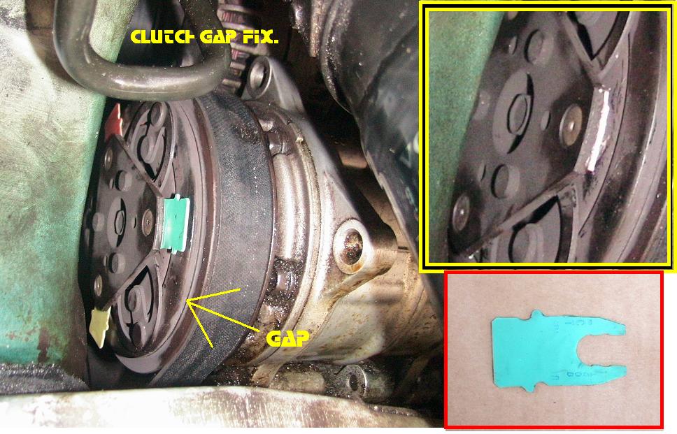

Pina atunci, ai rezolvare mai usoara, fara a fi nevoie sa dai ambreiajul jos. Tot ce-ti trebuie este putina indeminare si...3 bucati tari de plastic - pe care,dupa ce le dai o forma de furca ce "imbraca" surubul, le impingi acolo. Scopul este sa refaci distanta de 0.4mm. Uite si poza si textul luat de pe volvospeed.com  - sper ca stii un pic de engleza, e ora 2 noaptea si nu prea am chef de traducere  :D

Next time the compressor clicks off (starts blowing warm air): leave the a/c on and take a wooden broomstick and push the clutch in with it. If the clutch engages with the push of the broomstick, you know thats the problem.
If the compressor is clicking on and off constantly every couple seconds, then thats a different problem, probably low freon.
Complicated fix:
Requires taking the clutch apart and putting/extracting some shims...
Easy fix:
Take 3 plastic bread bag clips and insert them on the outside of the clutch to push the clutch closer to where its supposed to be so it can engage automatically.
You'll need to cut the clips the way they look in the picture so they fit (it will all make sense when you try sliding them in place). I used a flat head screwdriver to spread the clutch apart while I slid the clip in. I also put crazy glue on the clips just to be certain they are not going to fly out with the centrifugal force. Make sure you work quickly once the glue is on because it will soften the clip. Once they are all in just break off the end of the clips. The bread clips were just the right size for my compressor but yours might be different. My brother's S60 is having the same problem but the clutch is different. The gap is smaller and a bit harder to get to, I'll probably cut up some copper sheet metal or maybe some old razors and slide them in.
It took me about 15 minutes when I did it about a year ago and it's still working."

multam fain!!! stiu engleza si am priceput, acum ma gandesc cu ce as putea inlocui bucatile alea de plastic, poate cu niste bucatele de tabla de grosime potrivita. Mult mai buna solutia asta, desi impins cu ranga mai tare de vreo doua trei ori si pare sa mearga  (pentru o vreme)(nu recomand insa solutia deoarece ii cam intrusiva si violenta)

Distantierele din plastic nu pot fi croite dintr-un card vechi, sau dintr-o cartela telefonica?
Zic eu...    ;D
din orice plastic tare, oricum citeva incecrcari trebuiesc facute...grosimea lor...cum stau acolo...Important e cum le "croiesti" gheara aia, ca sa prinda printr-un click suruburile alea 3.
Tehnica merge la aproape toate compresoarele !  ;D ;D
Ce am vazut mentionat si pe alte forumuri e sa le lipesti cu ceva poxipol sau ceva lipici tare ca sa nu zboare "saibele" la turatii mai mari din cauza fortei centrifuge !

subscriu, operatiunea nu ii complicata, poate un mic migaloasa si trebuie sa gasesti niste tabla ceva mai groasa si ceva cu care sa o decupezi (cu oleaca de noroc poate gasesti ceva care sa se potriveasca direct)(anunta-ne si pe noi). Eu m-am gandit la cartele telefonice dar probabil se topesc asa ca nu ii o alternativa buna. Oricum ar fi daca nu gasesti si vrei un quick fix, ia o ranga si impinge zdravan exteriorul ambreiajului de cateva ori la mine a mers treaba asta si de vreo 2 sapt am AC functional (ps: nu exagera si fa operatiunea cu grija sa nu strici ceva pe acolo). Totusi daca ai un prieten ceva mai priceput incearca sa faci treaba cu distantierele.
