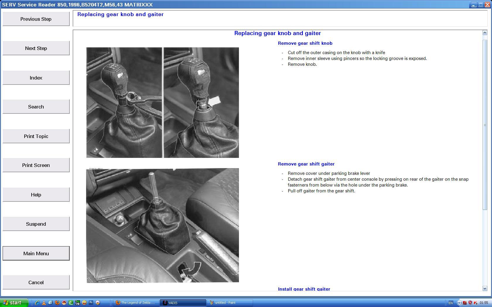

Conform VADIS-ului:
To remove gear shift knob
-Cut off the outer casing on the knob with a knife
-Remove inner sleeve using pincers so the locking groove is exposed.
-Remove knob.

Exact asa se face, se taie nuca, se taie colierul si se trage in sus, de bagat se baga tot greu ;D
