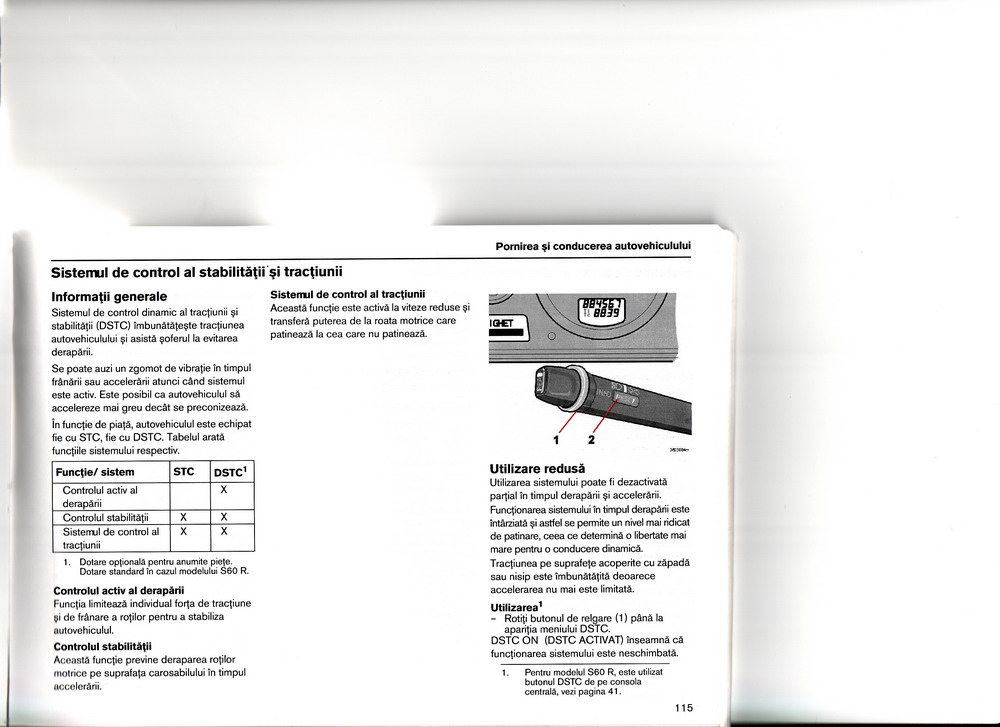

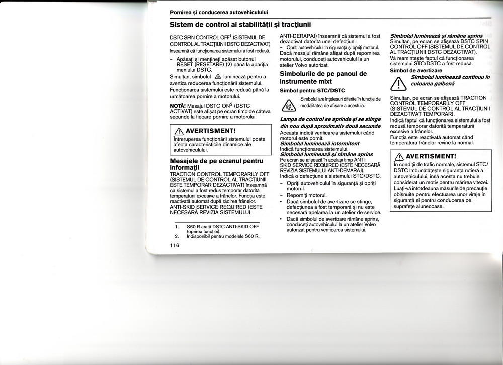

Am gasit in cateva locuri pe net referiri la DSA de genul:
Volvo's torque-limiting Dynamic Stability Assistance
