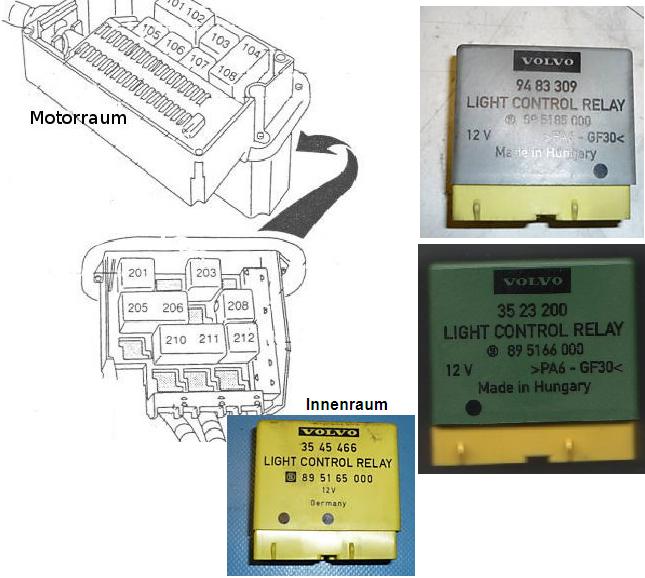

"Hello, my review is for those of you who wish to implement follow-me-home function with your 850/V70.
Implement the following measures: a relay 104/108, the well-known Light Control Relay, top right of the engine compartment lid controls this - with a Torx - Screwdriver and remove the fuses + relay lie before you. There is 3 models: the green / yellow, the yellow and gray with yellow yellow green, the base I have found at - and this I did. I have in the bay the gray / yellow - is just a Plug & Play operation! This is in contrast to the other one connector more - as in Volvo's all pre-wired, installation is super easy! flap to monkey dead - Try it! after killing the ignition key pull the top-position and can simply pull the high beam lever back - you have now for 30 Sec. Light car finish - with lighting and can go home smiling."
Are si poza, pe care o atasez. Sint curios cum va merge.

Ei, acum sa vedem cine are de dat si cu ce pret (cine gaseste primul) releul cu nr. 9483309 - ca sa spuna si celorlalti "suferinzi" daca merge.
14 euro, la ei acolo. Aftermarket, conform cu OEM-ul (care e 108 euro !!) = OEM number(s)9459171, 9483309
