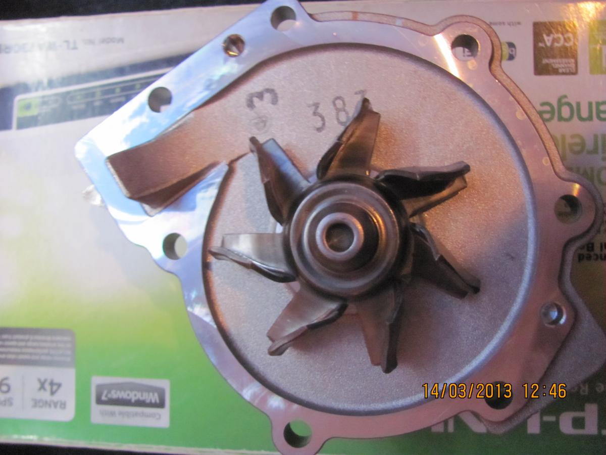

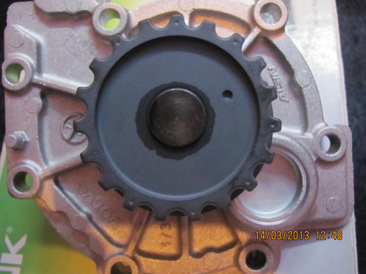

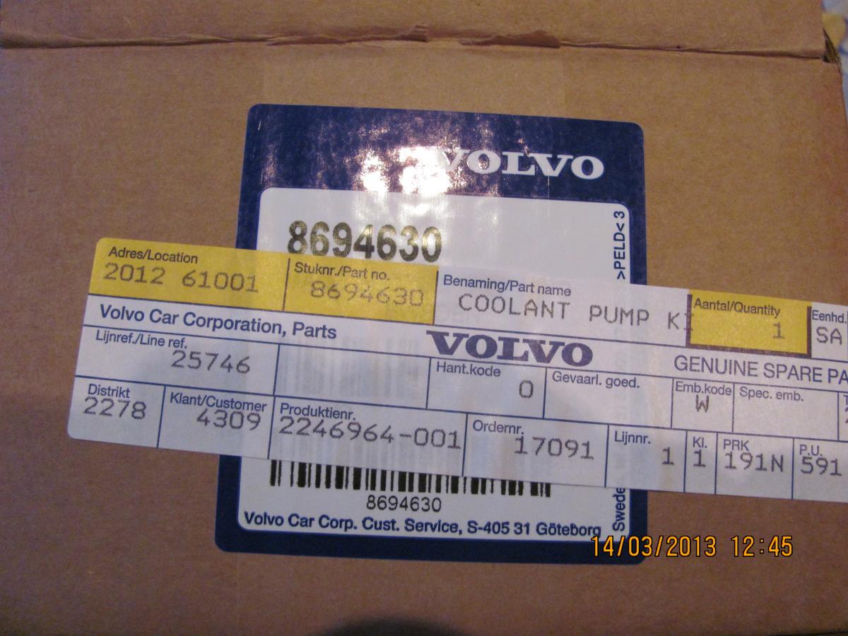

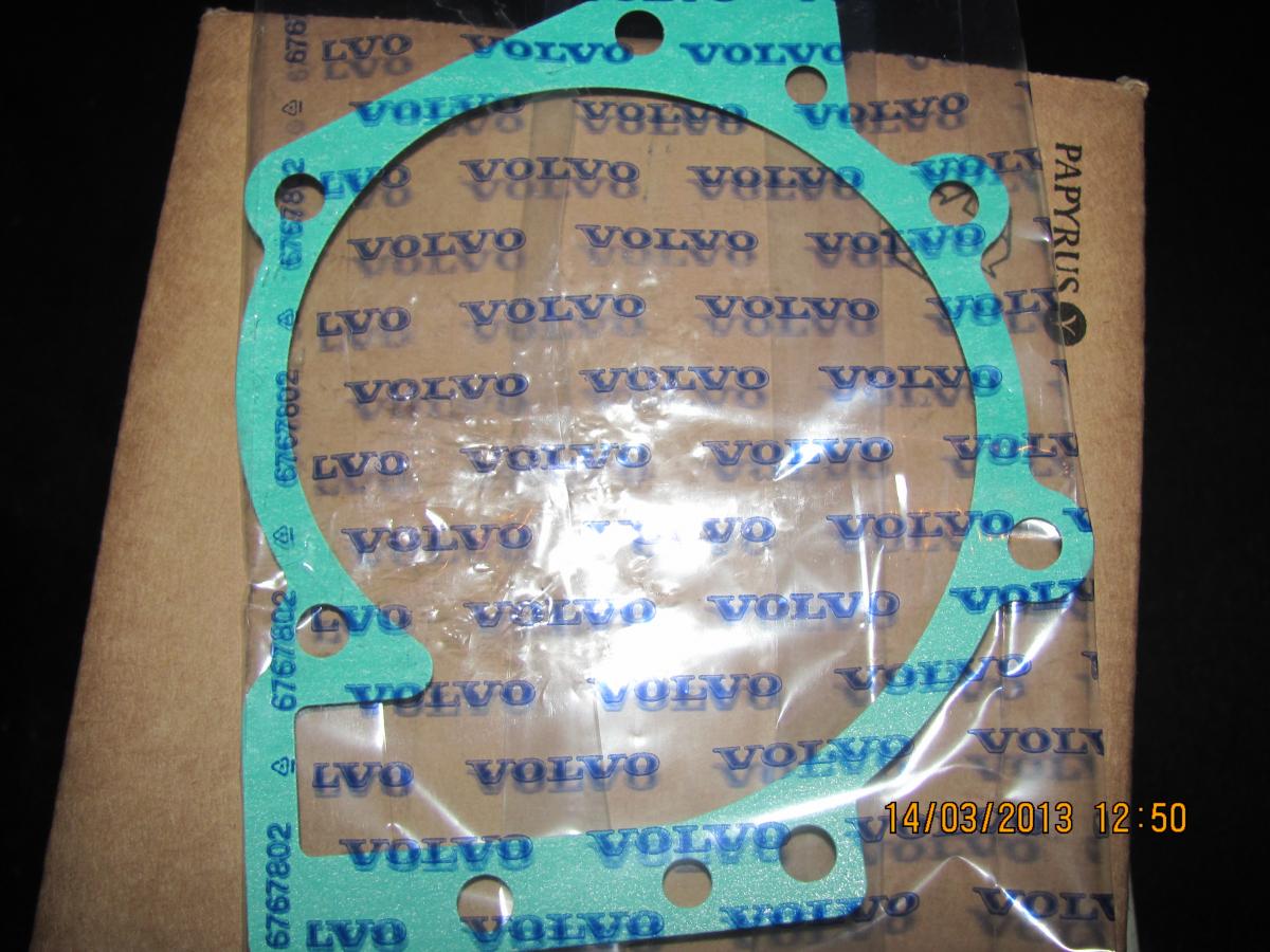

Salut . Am cumparat distributia si pompa de apa pentru d5 cod motor d5244t 120kw pe original.

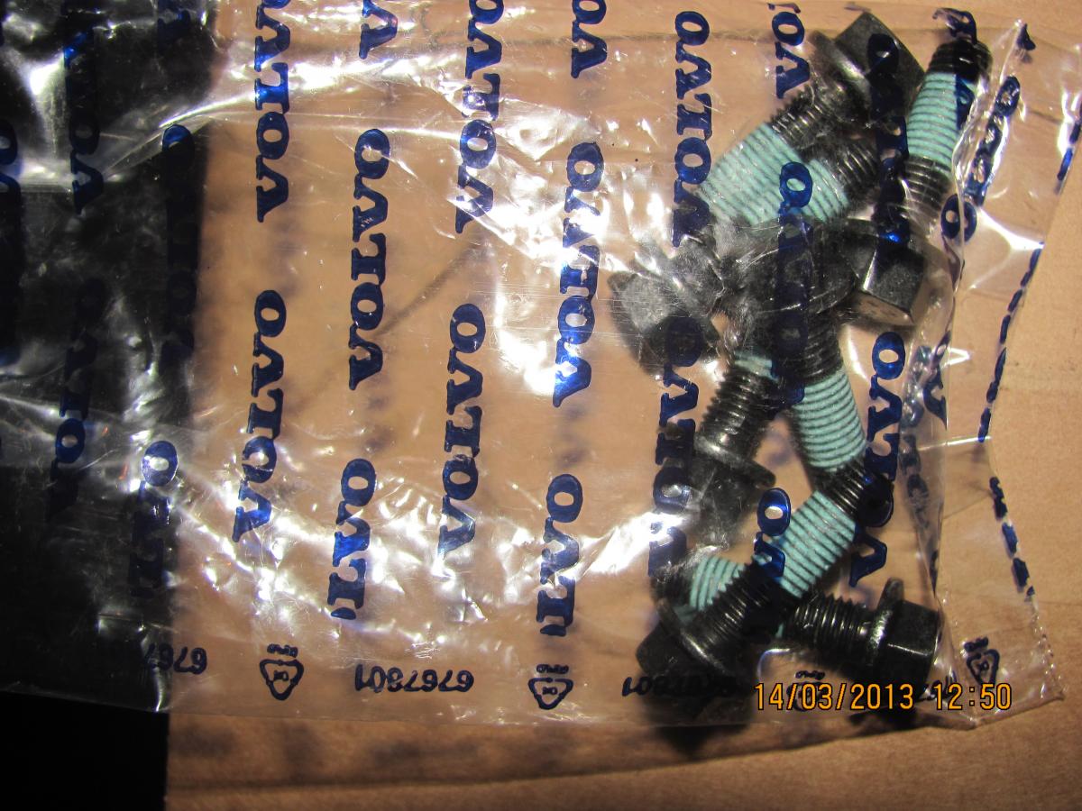

Pompa de apa pn:8694630 In cutie a venit pompa pe producator aisin garnitura si suruburile pret 140 europost-3286-0-81358900-1363255845_thumb.jppost-3286-0-63346400-1363255894_thumb.jppost-3286-0-12582000-1363255924_thumb.jppost-3286-0-30138200-1363255951_thumb.jppost-3286-0-98532600-1363255971_thumb.jp

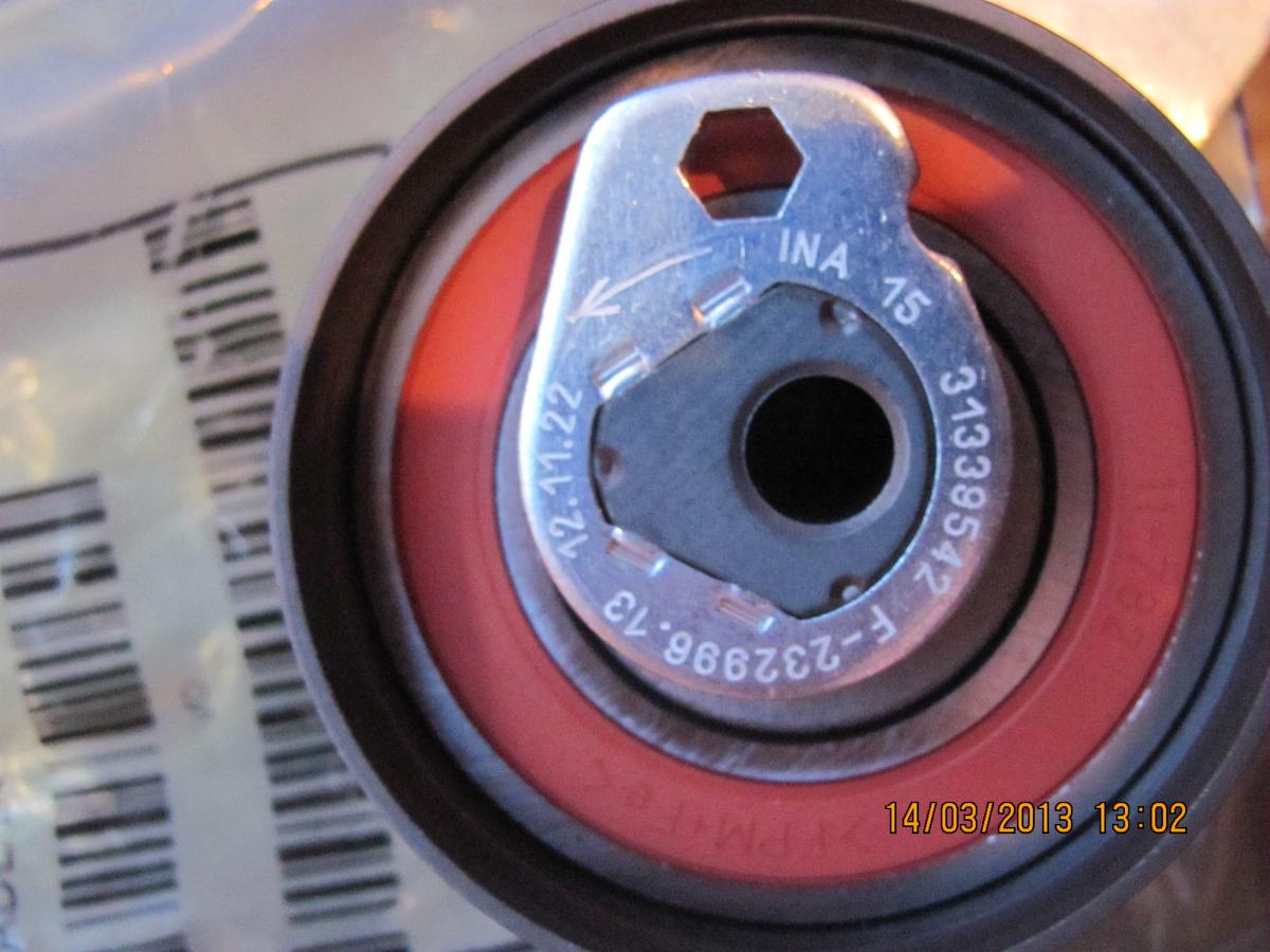

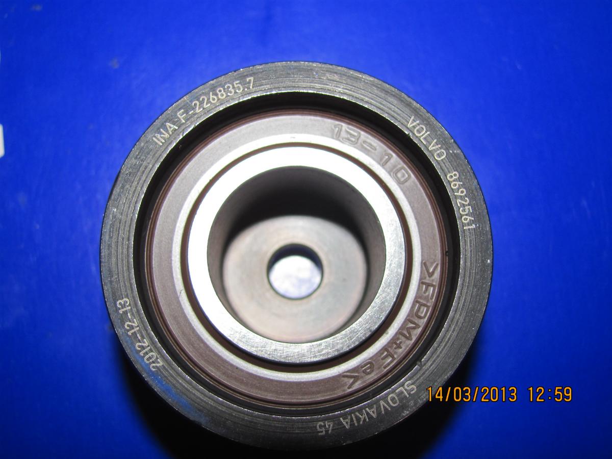

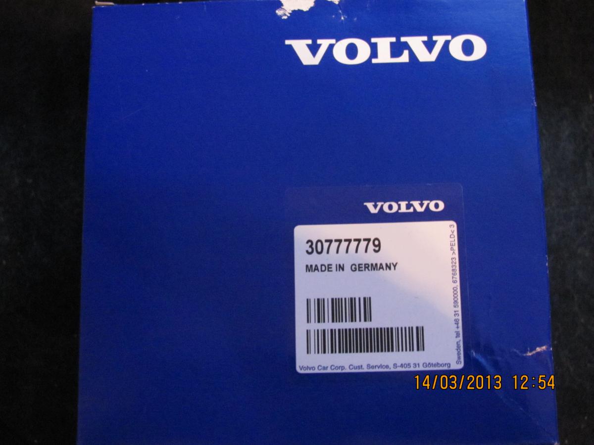

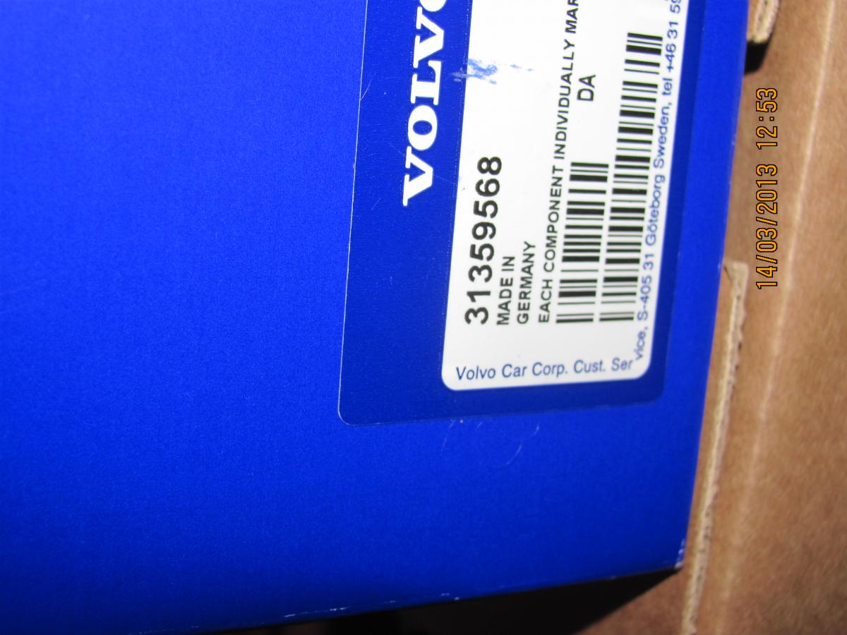

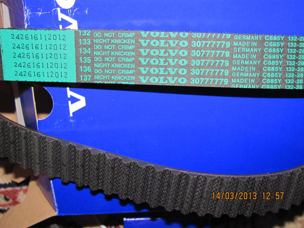

Chit distributie pn:31559568 care cuprinde curea pn:30777779 rola ghidaj pn:8692561producator ina rola intinzatoare31339542 tot chitul a costat 160europost-3286-0-15166800-1363256644_thumb.jppost-3286-0-76275400-1363256666_thumb.jppost-3286-0-12794500-1363256693_thumb.jppost-3286-0-37733300-1363256773_thumb.jppost-3286-0-20566900-1363256850_thumb.jppost-3286-0-38853100-1363256875_thumb.jppost-3286-0-32954600-1363256891_thumb.jppost-3286-0-24115300-1363256903_thumb.jp

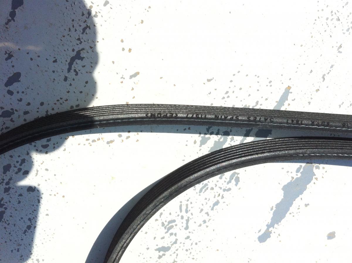

Cureaua auxiliara oem este gates made in spainpost-3286-0-08536700-1364930344_thumb.jp
Edited by adrian mangalia
Cureaua de distributie e Volvo mai Doc . :D
