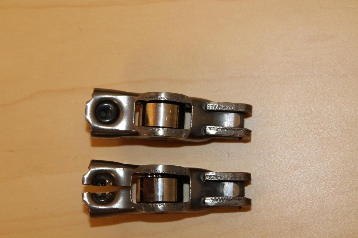

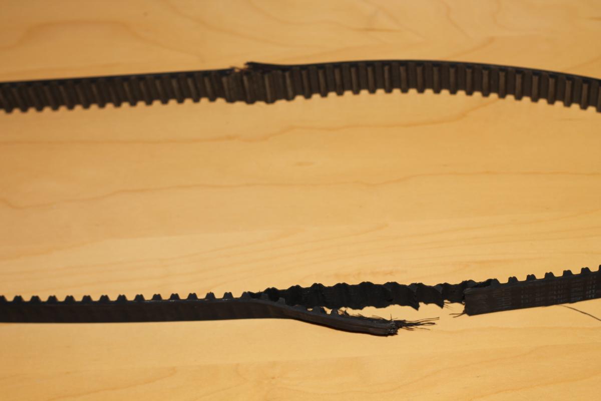

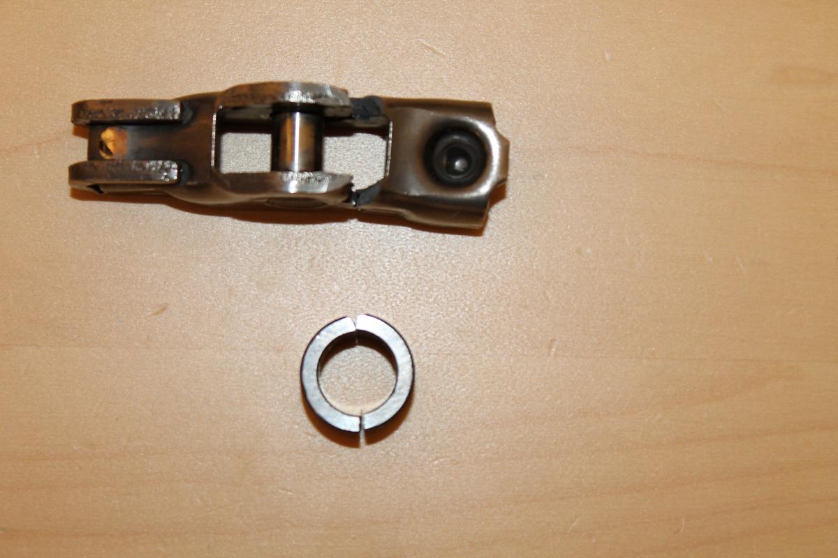

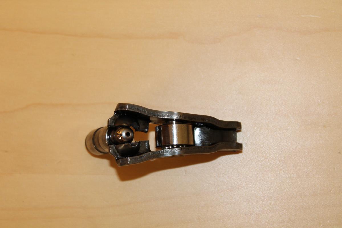

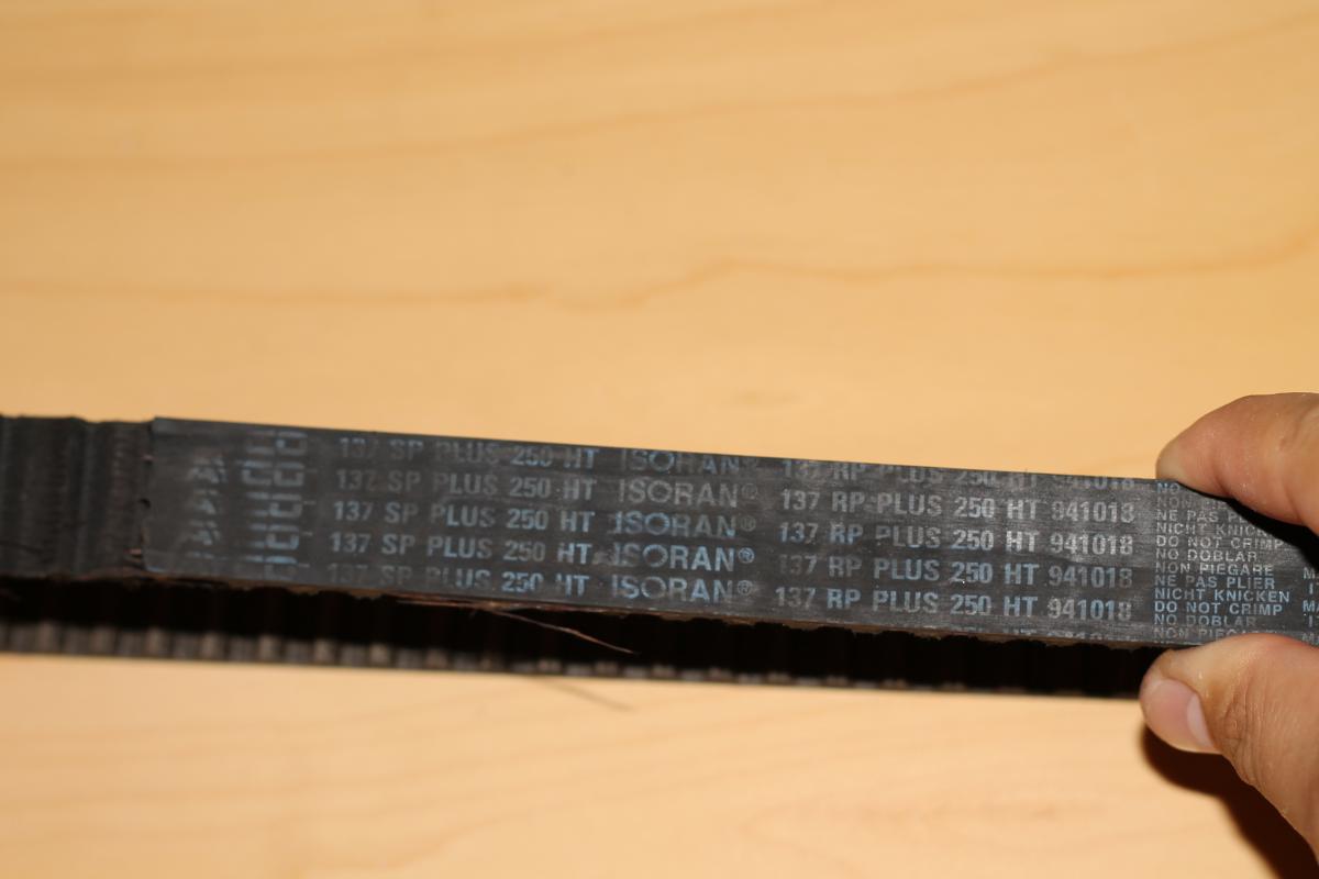

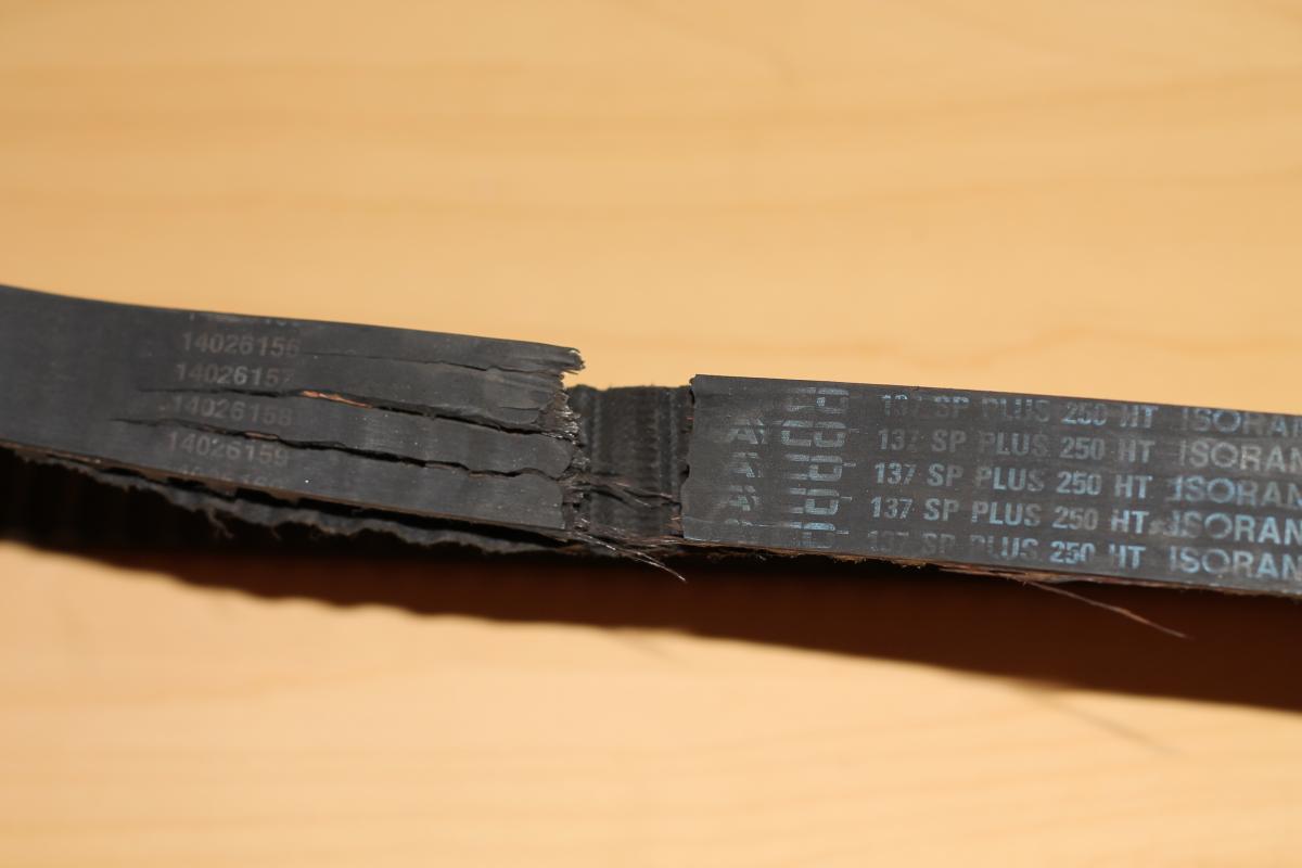

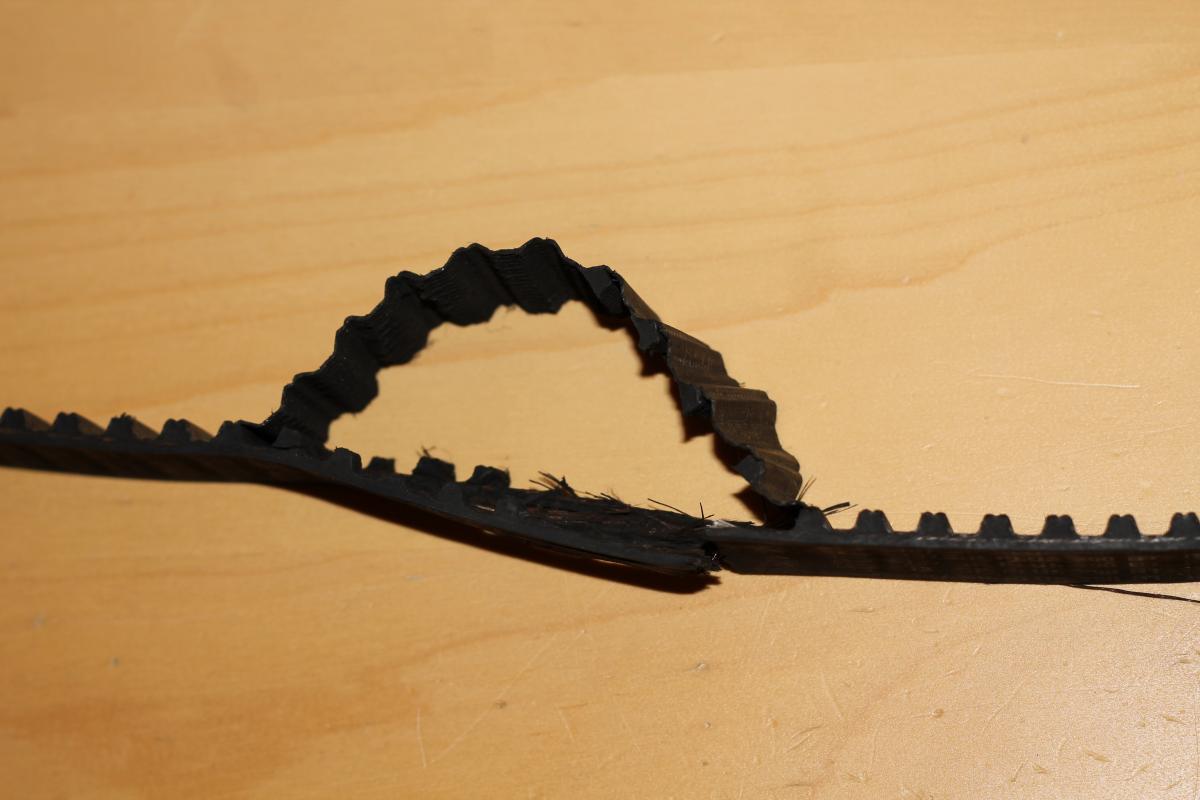

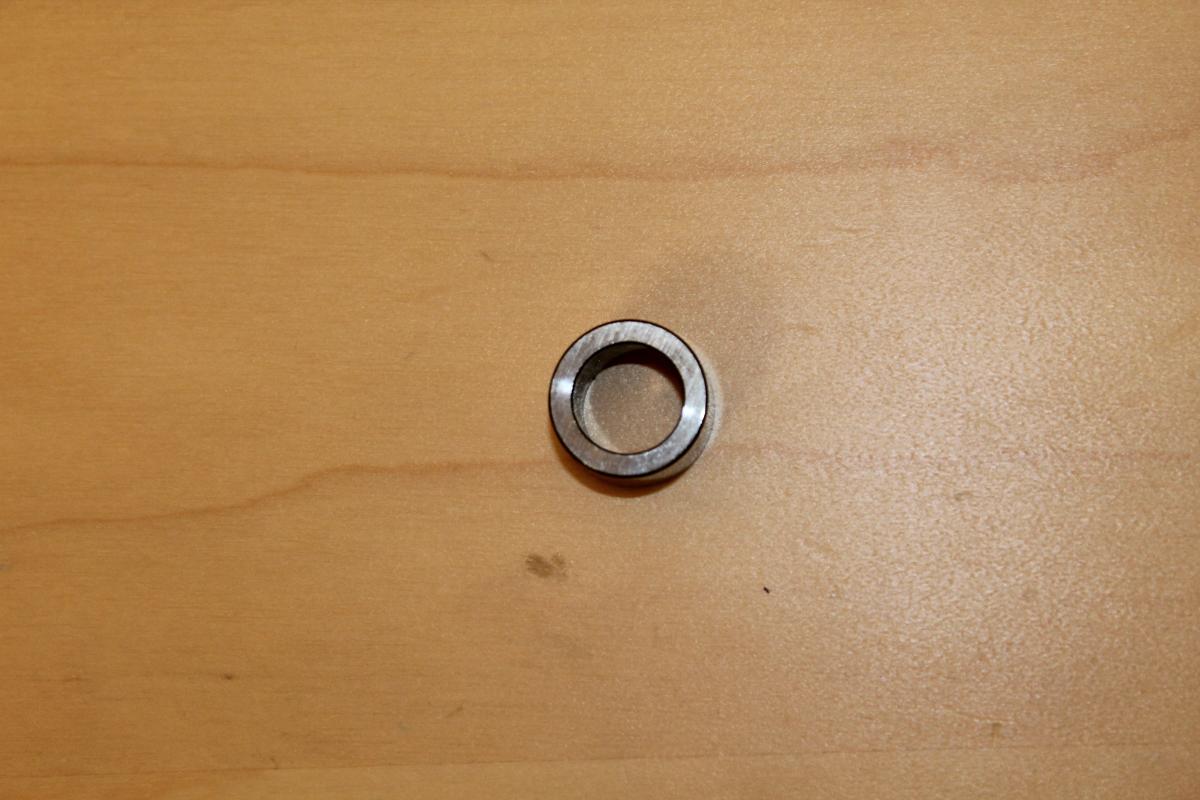

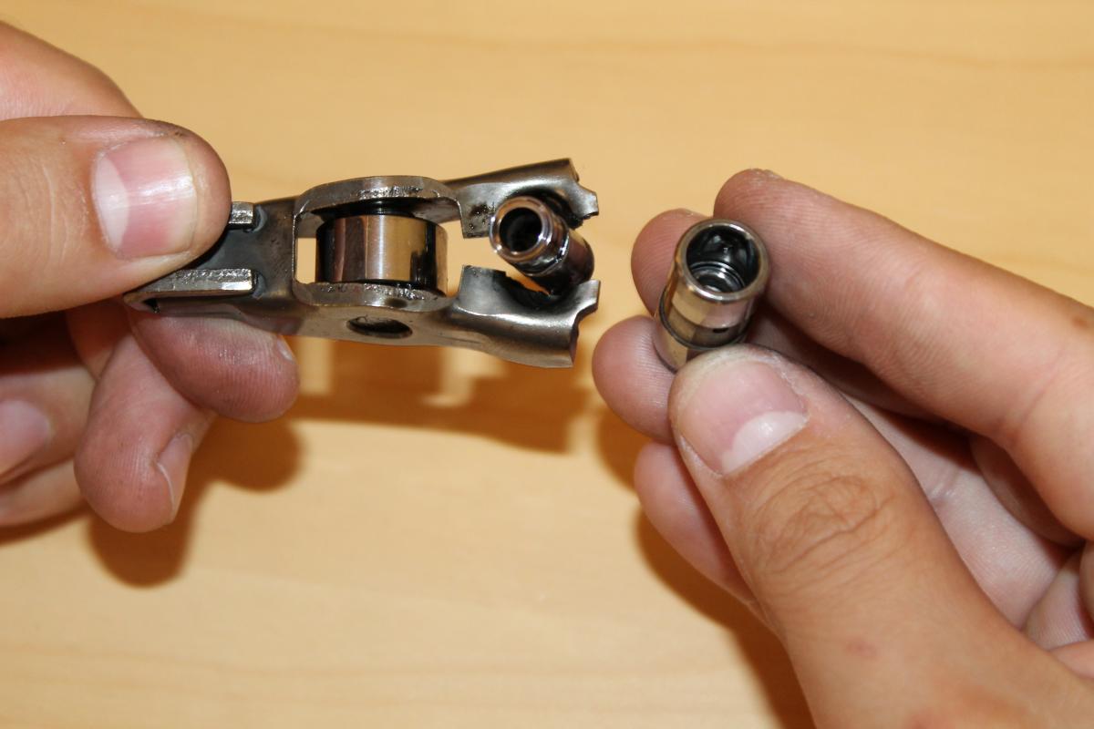

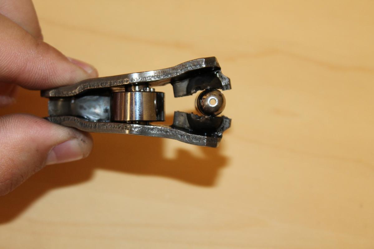

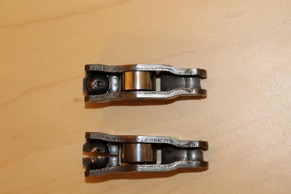

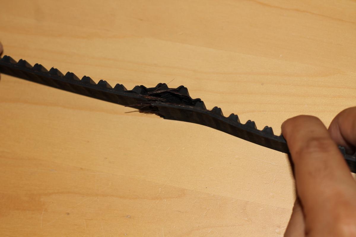

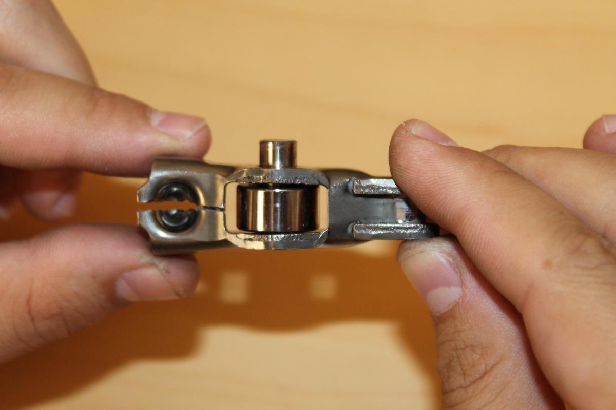

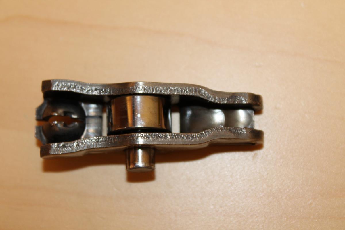

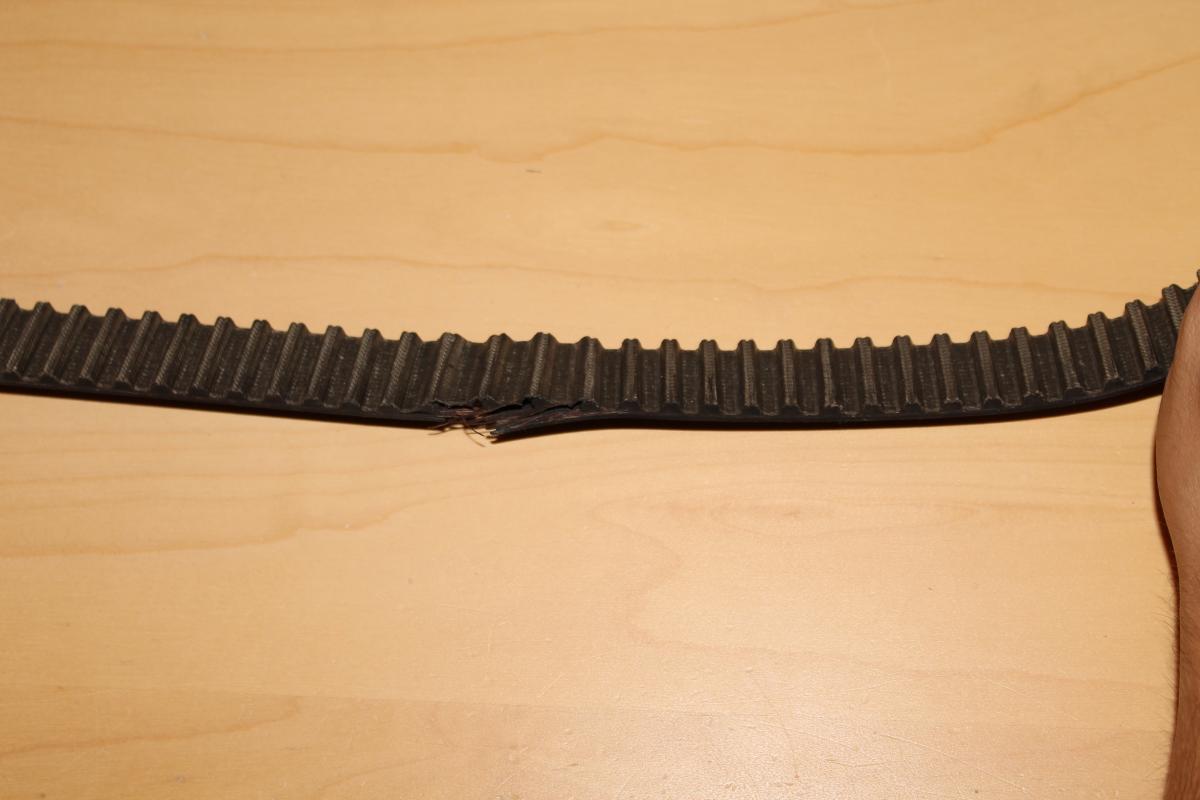

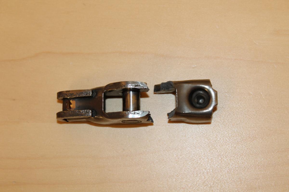

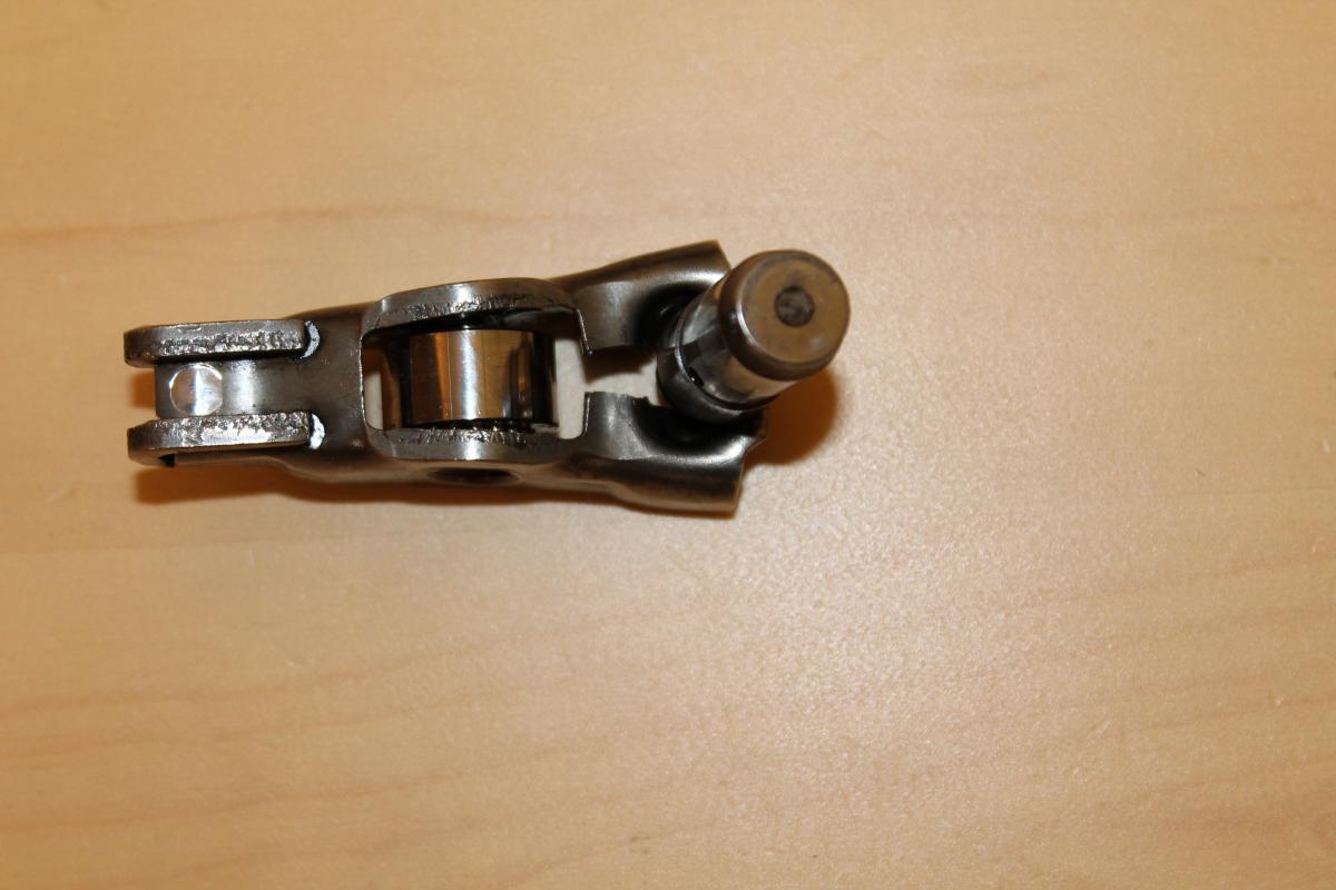

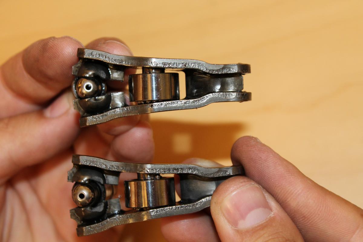

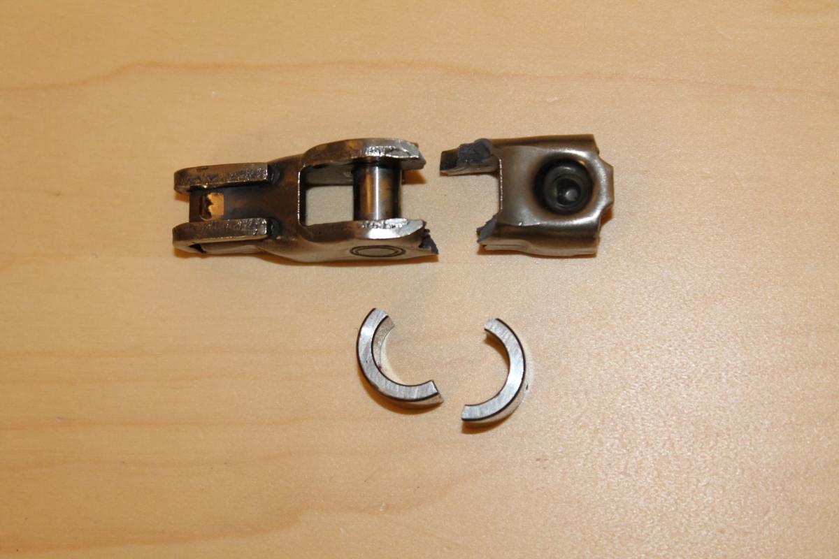

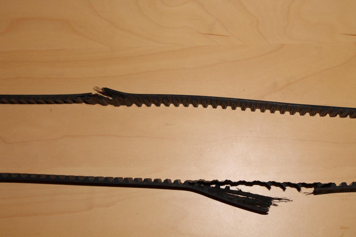

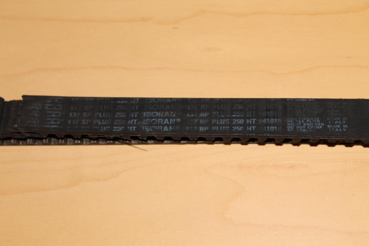

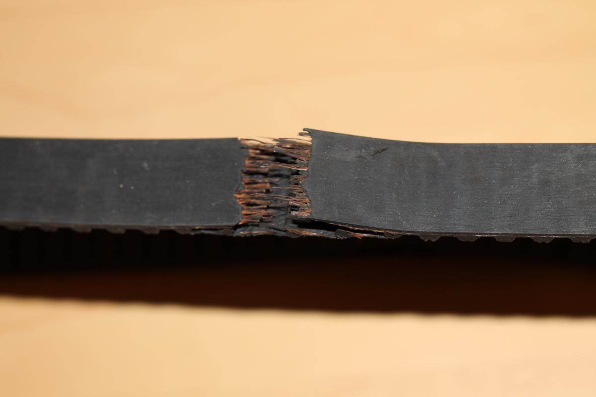

Astazi mi-am facut ceva timp si am pozat ce am mai oprit din piesele stricate.
Pe langa cele pozate, mai aveam axa cu came pe admisie distrusa; adica cama in dreptul cilintrului 4 ( numarand de la distributie spre volanta) pur si simplu s-a invartit pe ax iar pistonul respectiv nu mai lucra....si cateva supape indoite.(inlocuit chiuloasa)

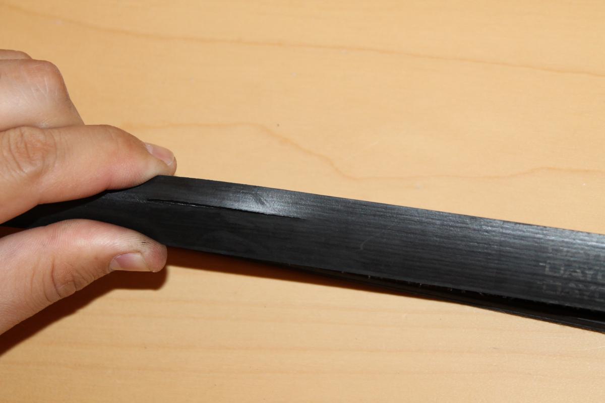

Aici avem cureaua de distributie Dayco - 5oookm
post-550-0-81631500-1410436573_thumb.jpgpost-550-0-40296200-1410436578_thumb.jpgpost-550-0-44486300-1410436584_thumb.jpgpost-550-0-11573700-1410436589_thumb.jpgpost-550-0-29621800-1410436595_thumb.jpgpost-550-0-41195200-1410436600_thumb.jpgpost-550-0-68409900-1410436608_thumb.jpgpost-550-0-96798700-1410436614_thumb.jpgpost-550-0-52062700-1410436620_thumb.jpg

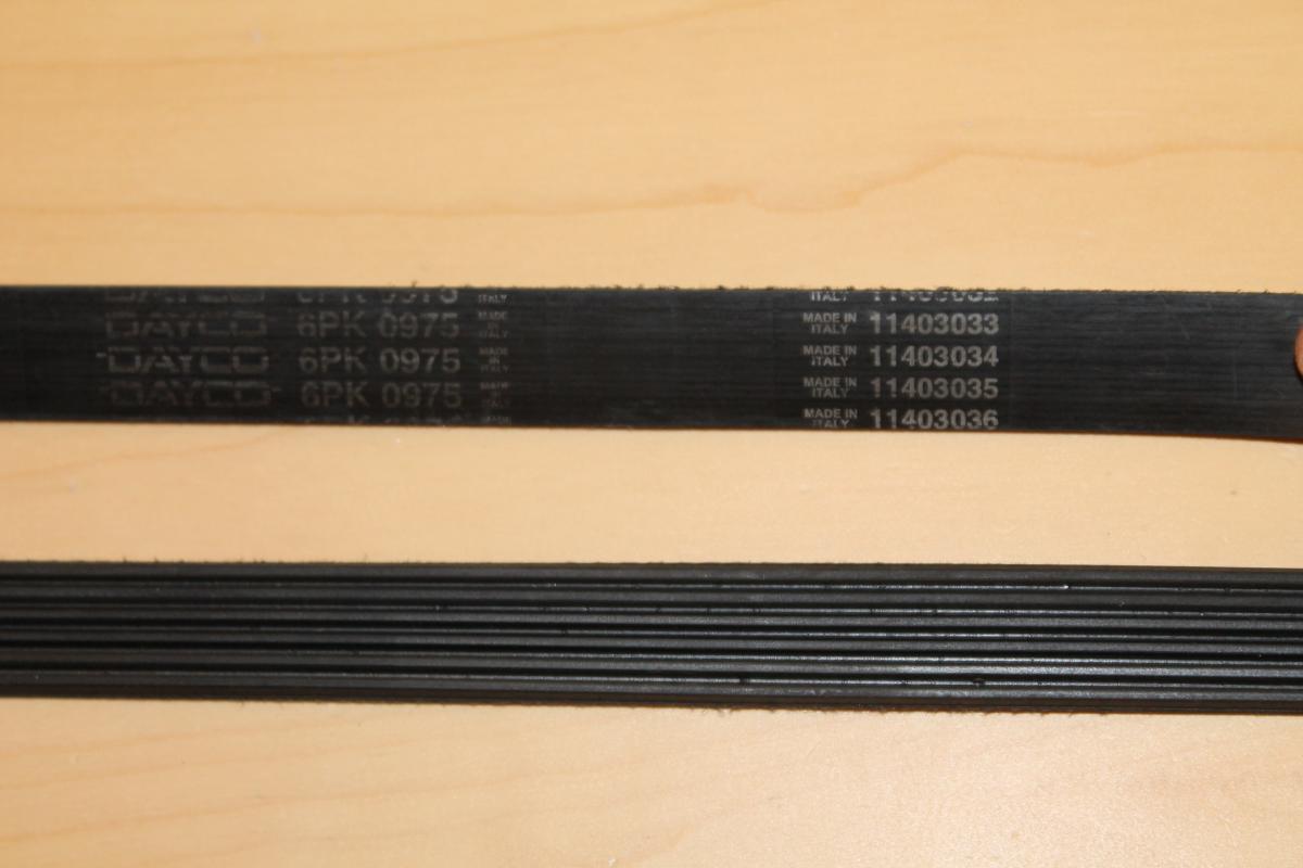

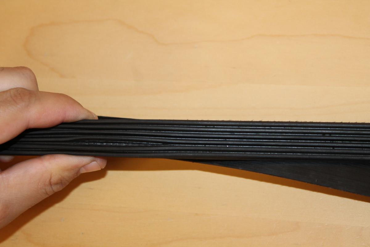

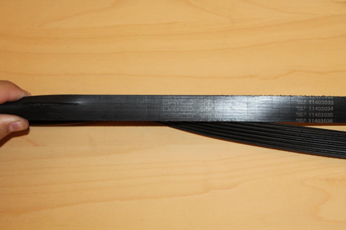

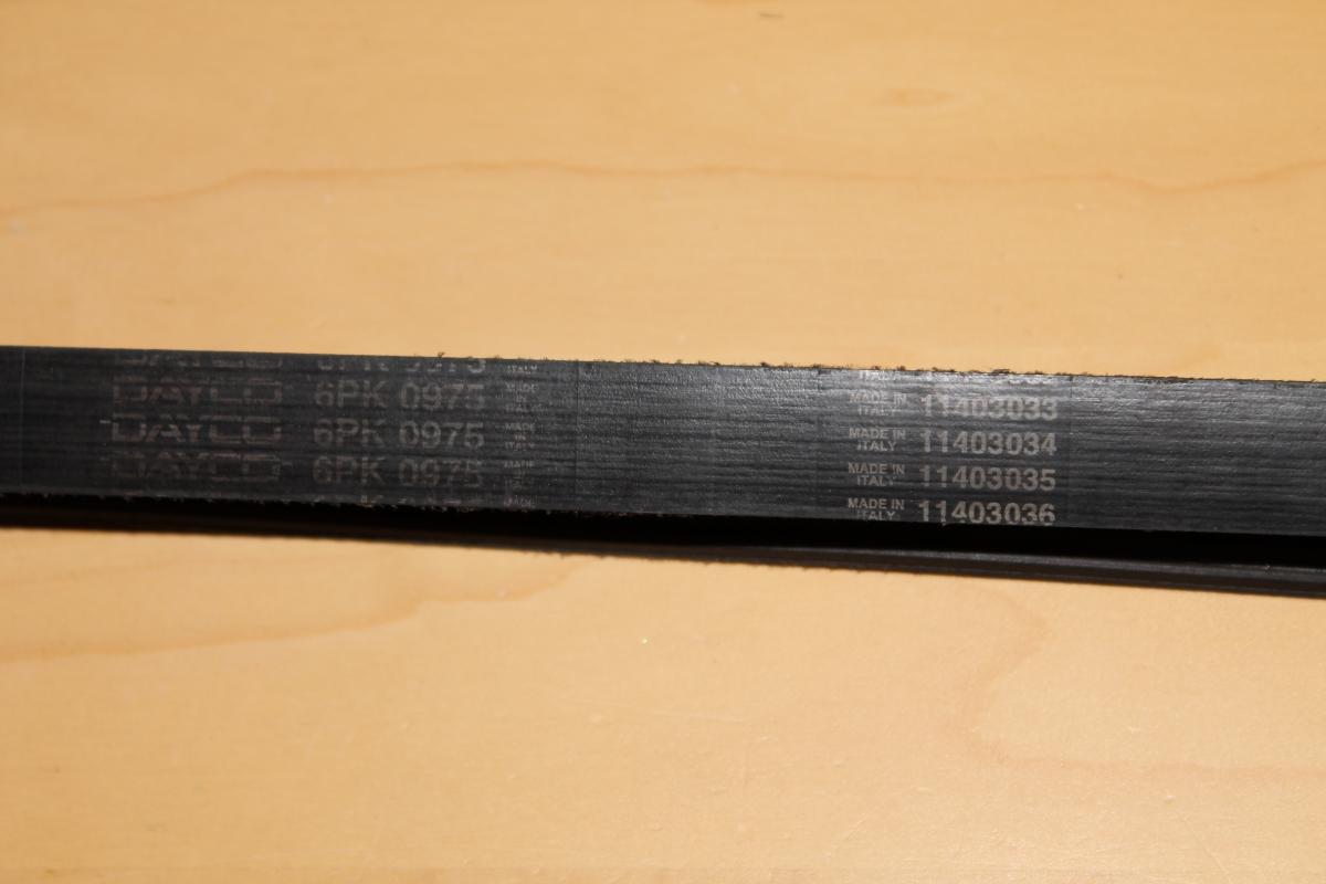

Iar aici este cureau de accesorii Dayco - 40oookm

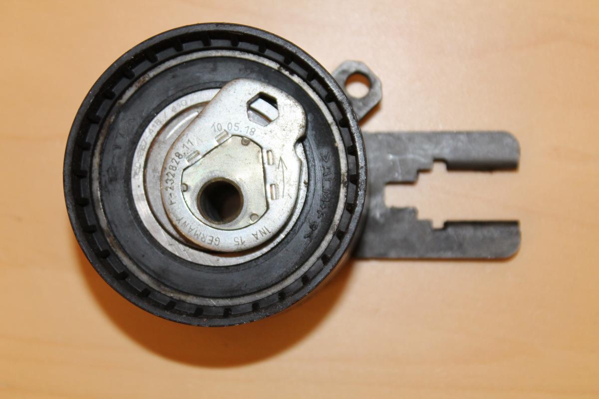

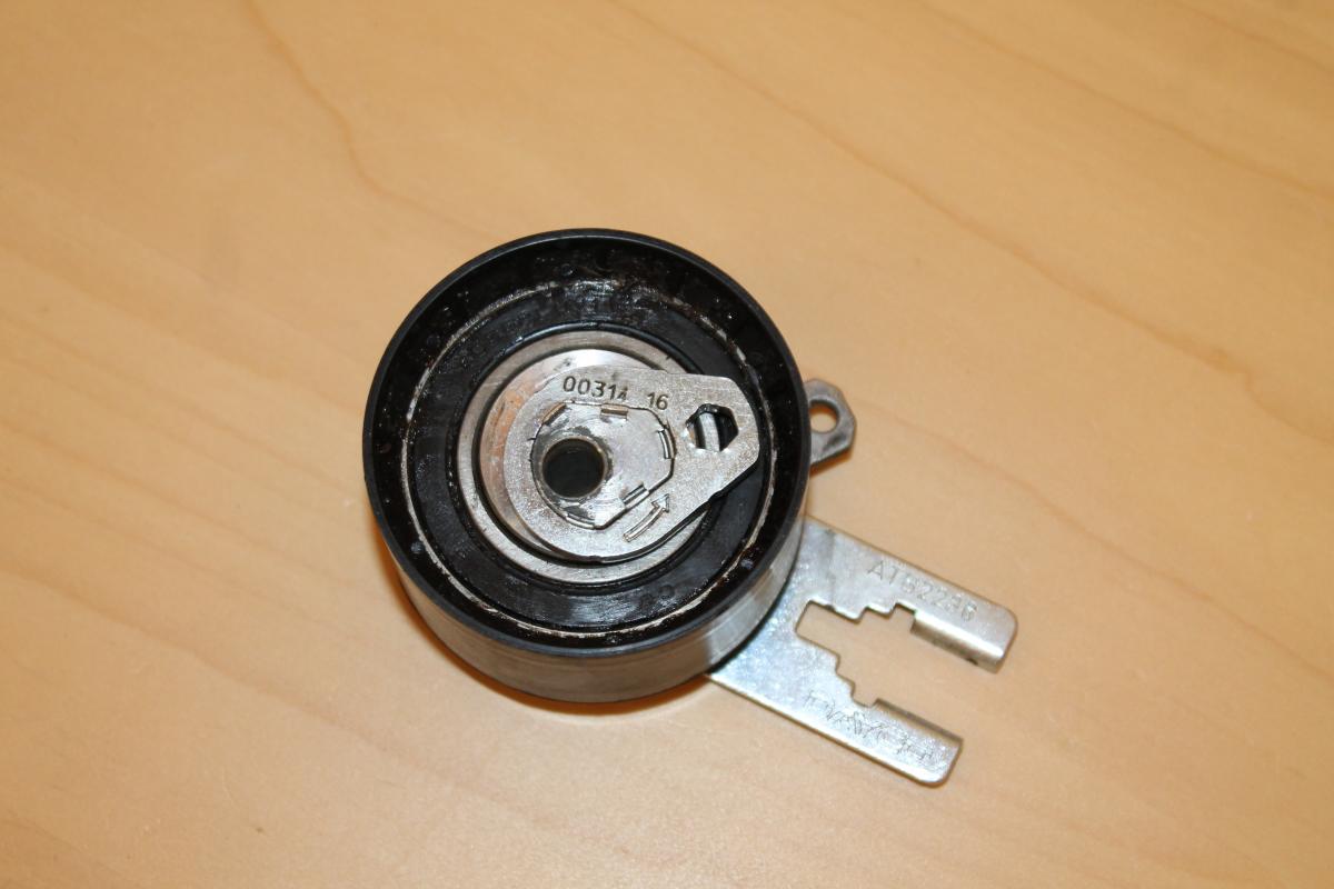

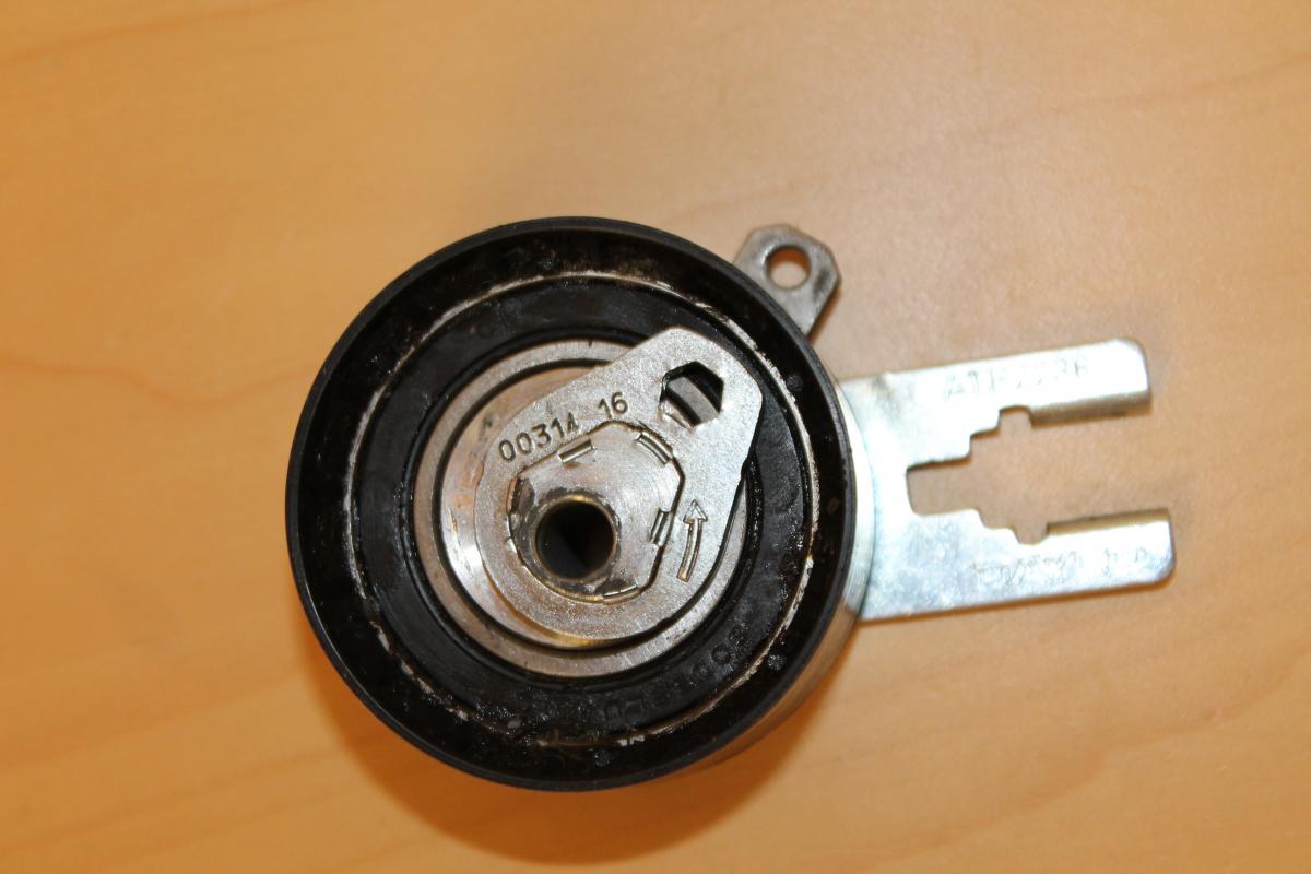

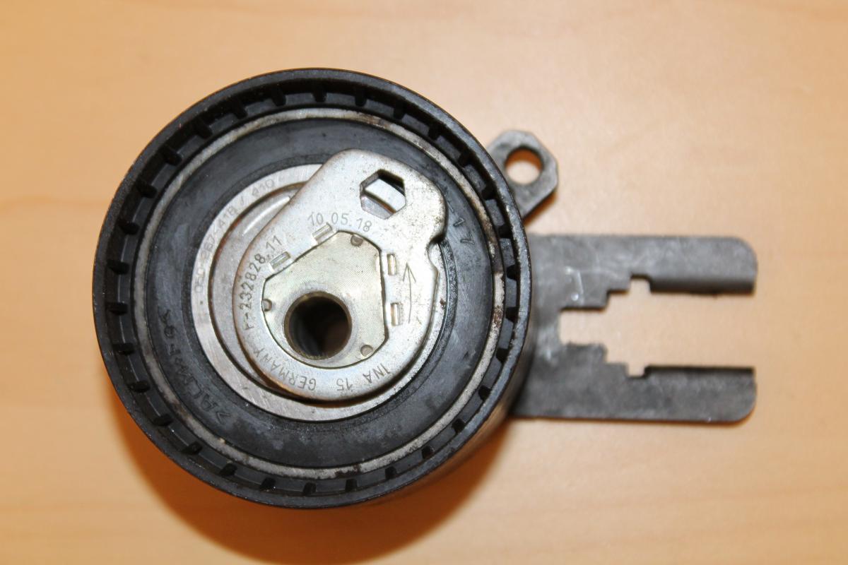

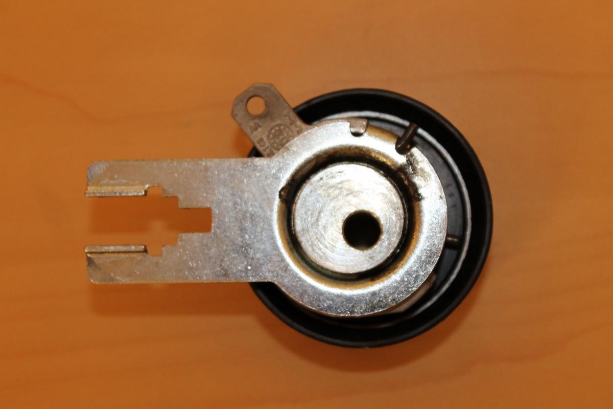

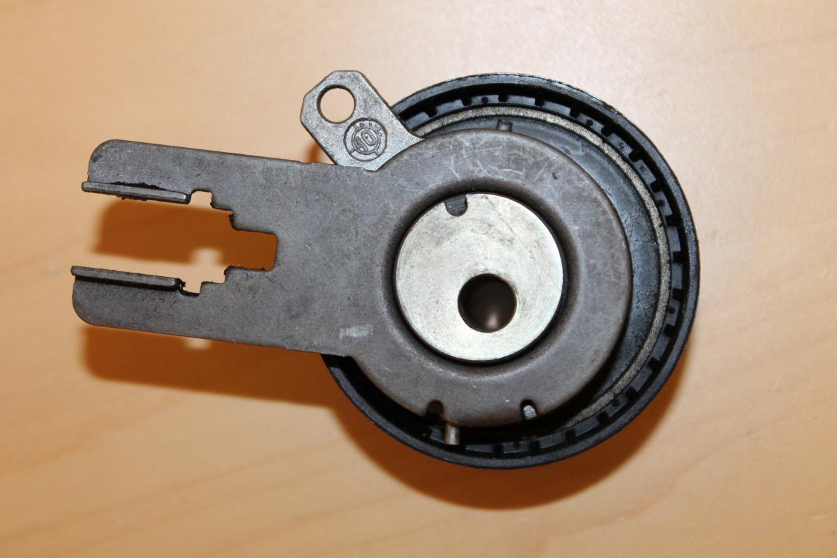

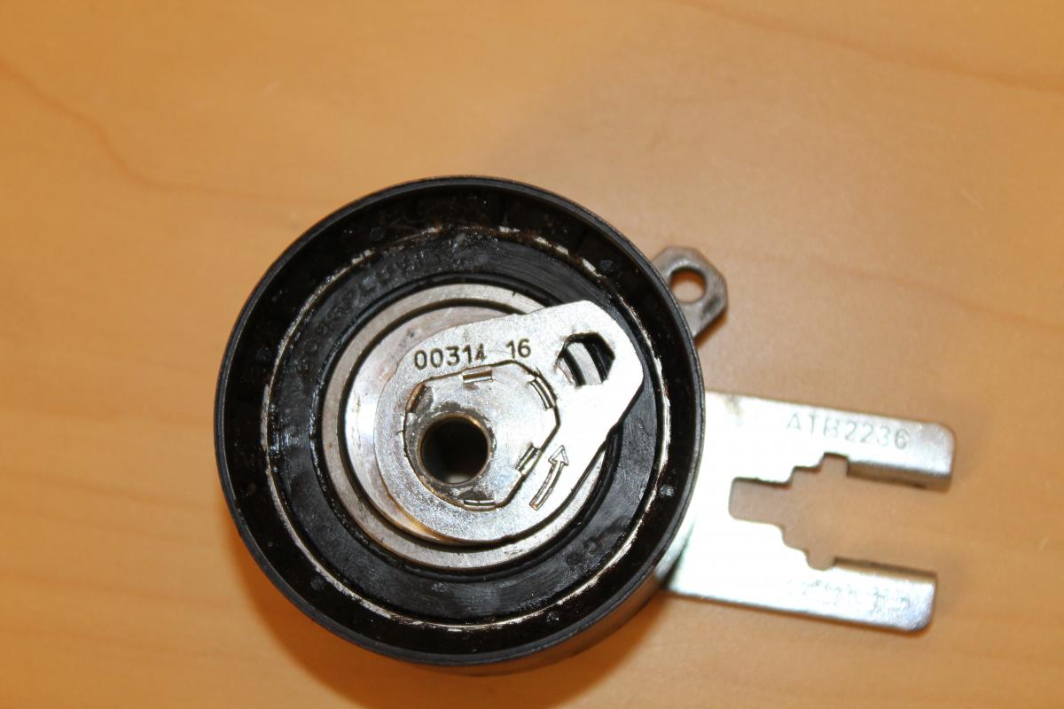

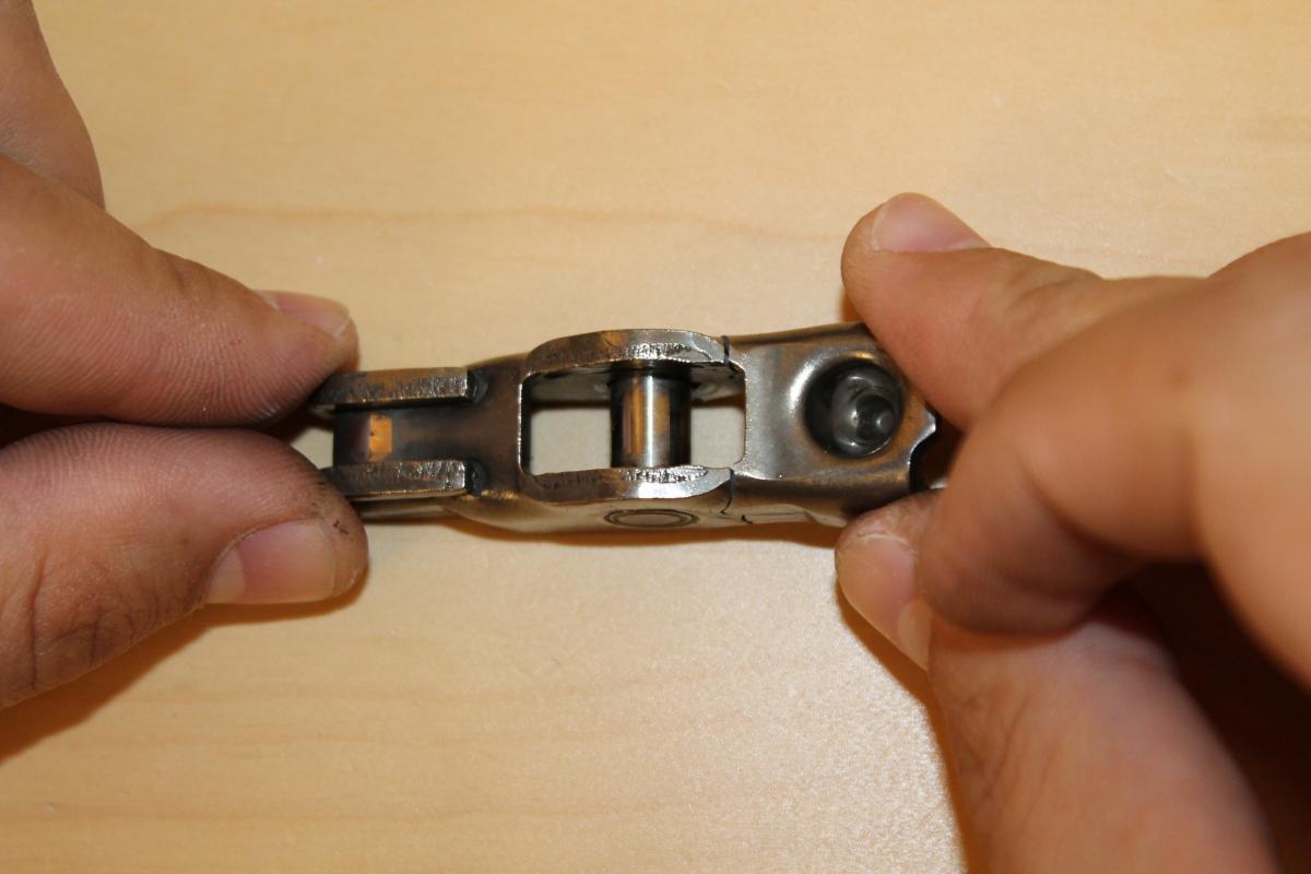

Rola intinzatoare Dayco, din care a iesit vaselina - 5oookm
post-550-0-88593000-1410436996_thumb.jpgpost-550-0-51406300-1410437003_thumb.jpgpost-550-0-32807000-1410437010_thumb.jpgpost-550-0-89273100-1410437016_thumb.jpg
Aici aveam rola originala care era pe masina atunci cand am inlocuit distributia la 180ooo INA
post-550-0-37337100-1410437144_thumb.jpgpost-550-0-03549500-1410437151_thumb.jpgpost-550-0-77687100-1410437157_thumb.jpg
Si cateva piese distruse
post-550-0-28775500-1410437217_thumb.jpgpost-550-0-36550500-1410437224_thumb.jpgpost-550-0-24007000-1410437232_thumb.jpgpost-550-0-57125900-1410437239_thumb.jpgpost-550-0-15732100-1410437247_thumb.jpgpost-550-0-23043600-1410437254_thumb.jpgpost-550-0-84937200-1410437260_thumb.jpgpost-550-0-85748300-1410437266_thumb.jpgpost-550-0-11062400-1410437282_thumb.jpgpost-550-0-48142300-1410437289_thumb.jpgpost-550-0-98306100-1410437296_thumb.jpgpost-550-0-76897100-1410437303_thumb.jpgpost-550-0-04673200-1410437312_thumb.jpg
